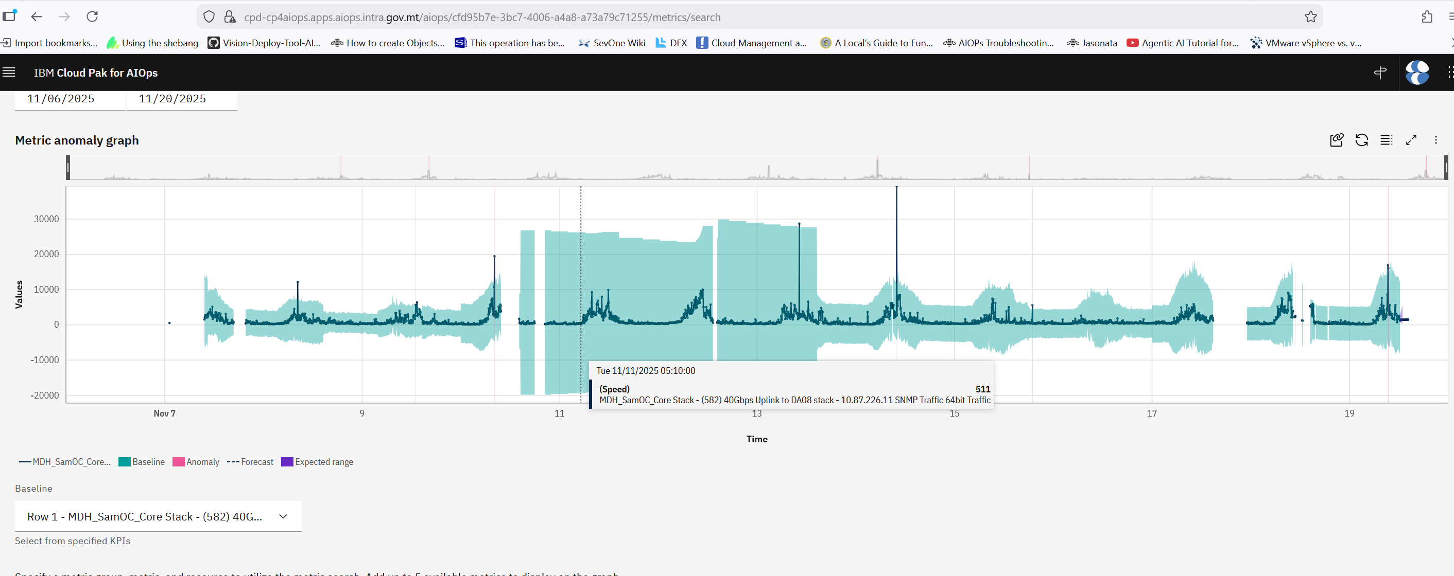

Need significant Improvements in AIOPs Metric Viewer Search UI page
Currently Metric Viewer Search UI page provide very basic controls and search and view capabilities and hence its very difficult to use for practical purpose on day to day basis. Here are few but not all issues and limitations of the UI that need to be addressed asap.
1) end user can't see full name of the resources in drop down list.
2) Unit of metric is not displayed on X axis of graph so no way to figure out what the values mean !!!!
3) Selected resources names are not displayed on chart ( unless u hover over the graph of them )
4) red line in graph indicate the anomaly data pointer but there no way to see the details of anomaly or launch in Alert viewer to see same anomaly

    Thanks for submitting this and thanks again for sharing the work you've done on this Martin!
    I'm going to mark this as Future Consideration for now. At this time, we're focusing our development resources on more impactful items which we believe will have greater benefit to users, but we recognise there is a lot of room for improvement in the Metrics UI and would like to revisit this when possible.

    Mar 25, 2026
    I end up building a UI and implement the API exposed by Metrics to search for the thing i need to. Looking for an element is most common than knowing the KPI or the Group it belongs. Maybe working on the Ux Search would be a good first approach.
