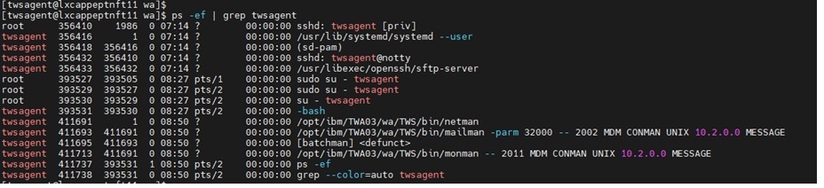

Tested in our testing environment(NFT), at the beginning we found out there is an issue on the FTA as the batchman failed to start and it be <defunct>
We investigate and found out this happened due to in Ceph client we are using fuse-client(Filesystem in Userspace).

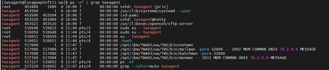

After we changed CEPH clients mounting using kernel client, TWS FTA finally able to started normally as no more batchman <defunct> and it contacted TWS MDM as usual.
